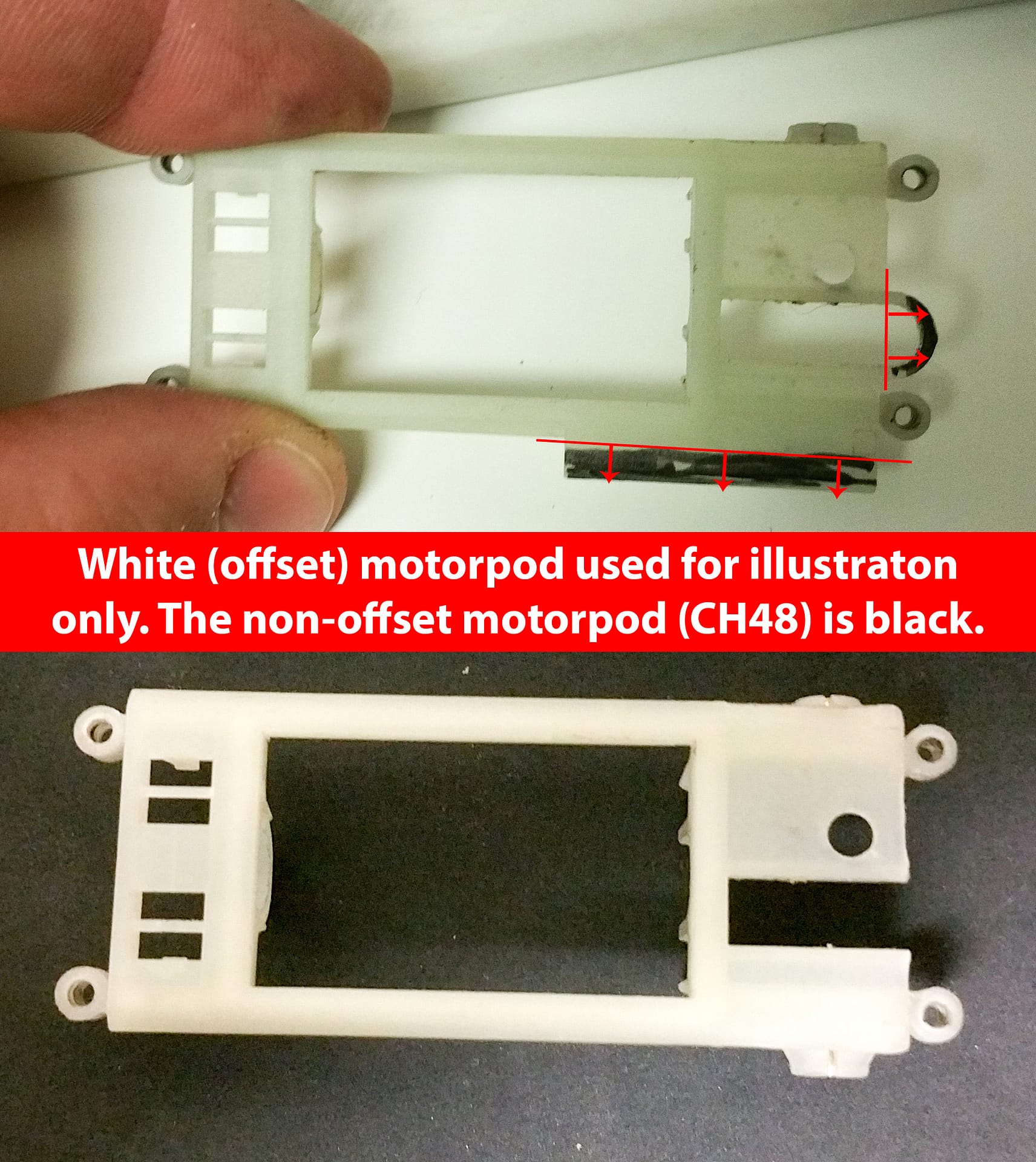

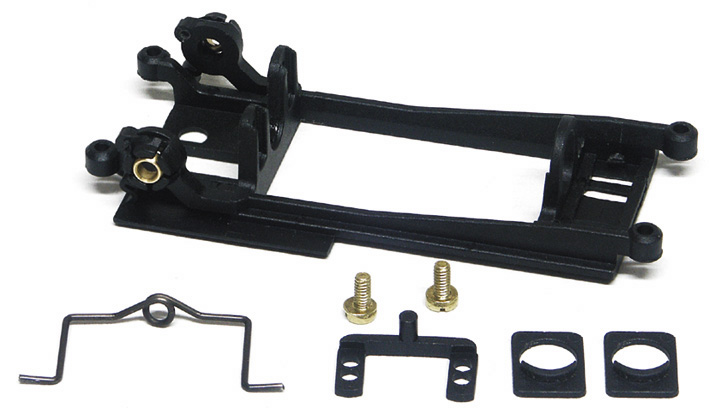

- Slot.it Inline Boxer non-offset motor-pod only, part # CH48.
- The motor pod needs to be modified in order to fit in the chassis. Allowed modifications are (use the following image as guide):
- Removal of crown gear protecting arch.
- Removal of rear side support.
