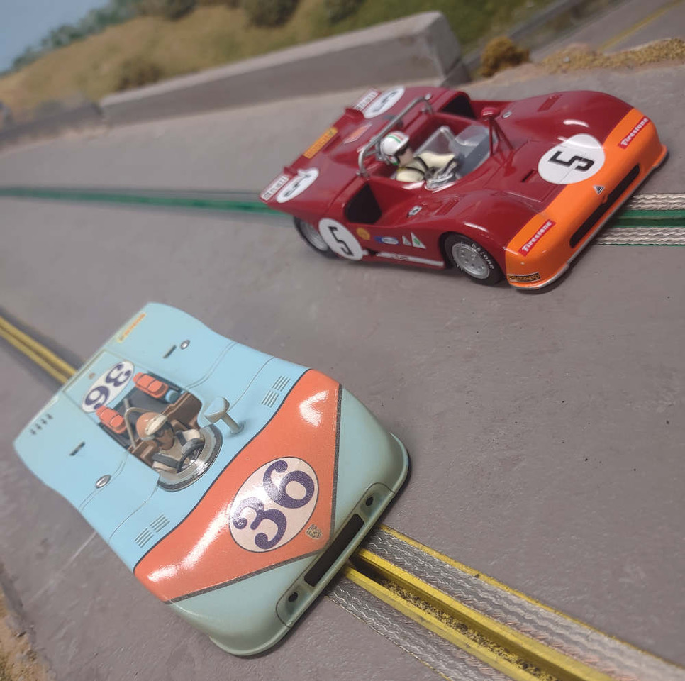

          in reply to: 2026 Q3 – Targa Florio 1970 to 1973 – Rally Track #30662
          Avatar photoDatto
          Participant
            On the car/livery issue. I got a couple of responses, but don’t know too much about what people are running, so its hard to tell you what people have currently been prepped.
            I am running Porsche 908/3 #36 Gulf livery, and Alfa Tipo 33/3 #5 Red with orange nose
            "Enjoy every sandwich"
            -Warren Zevon
