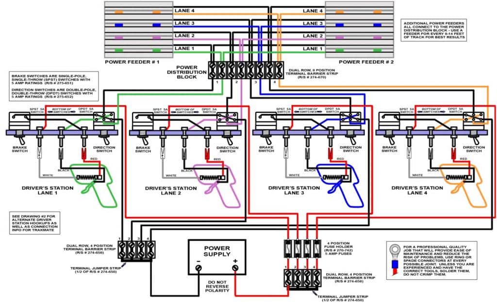

Track Wiring Diagram Home › Forums › Slot Car Talk › Tech Tips / Q & A / Tutorials › Track Wiring Diagram This topic has 1 reply, 2 voices, and was last updated 16 years, 2 months ago by Autorama. Viewing 2 posts - 1 through 2 (of 2 total) Author Posts July 21, 2010 at 10:11 PM #1986 Race ControlKeymaster This is the diagram I will be using on the track. The brake switch will not be present. Attachments:trackwiring.jpg July 23, 2010 at 8:44 AM #2008 AutoramaKeymaster XLR Pinout Author Posts Viewing 2 posts - 1 through 2 (of 2 total) You must be logged in to reply to this topic. Log In Username: Password: Keep me signed in Log In
