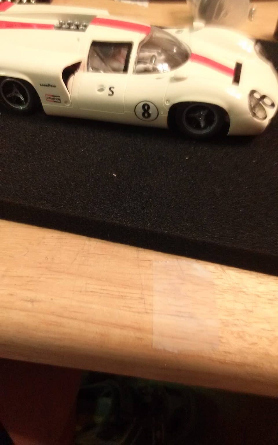

                          I would like to call Daytona 24 hours 1969 (#8) as my car for the Thunderslot series.
