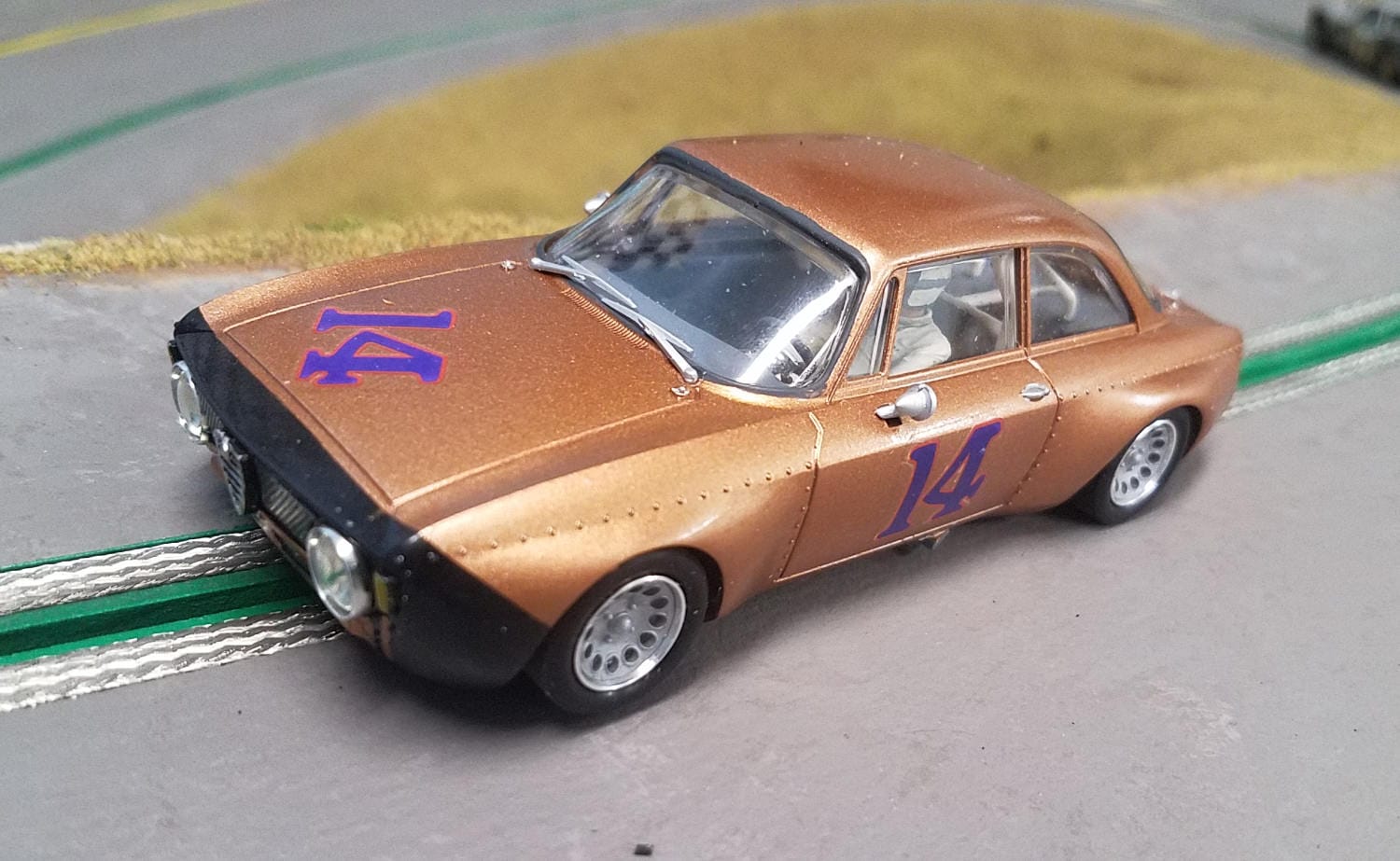

-Warren ZevonFebruary 16, 2023 at 10:45 AM #18758I’m running the blue Alfa. This would be very difficult to modify the car number so hope no others run this.
