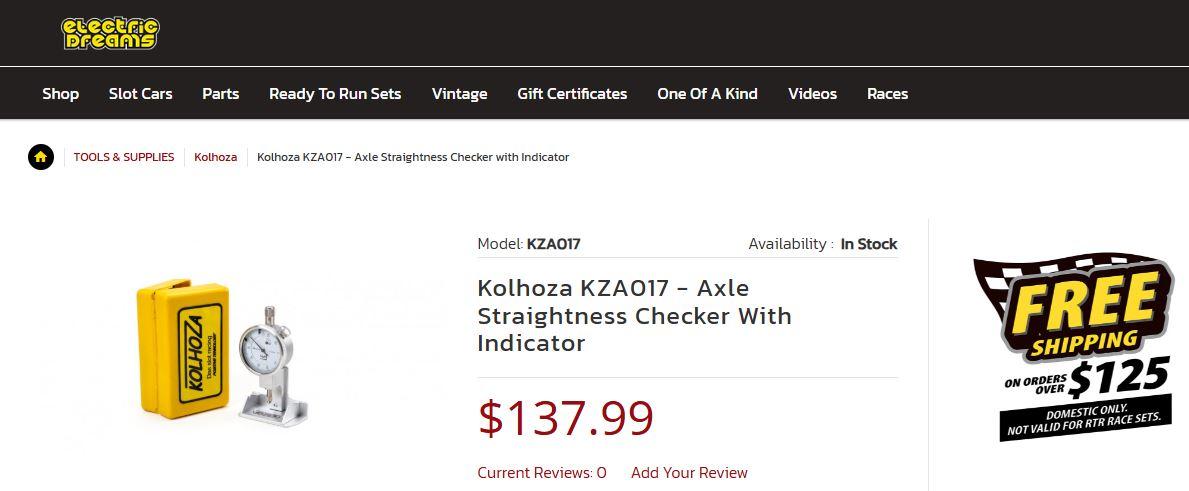

        I find it surprising how many axles on stock production cars are not straight.  I bet I throw away 70% of the stock axles.  It’s odd that a company like Slot.it has these untrue axles on their cars, but their aftermarket axles are straight.  NSR probably has the best quality axles on production cars.  I am sure that comes from overseeing all of their production in Italy.  I will say that their aftermarket axles are even better than the ones on their production cars.
        I use the Kolhoza axle checking tool and have had great success with it.  I know it might seem expenisive but it’s better than having your cars bounce around on the track without knowing why.

          I’m intrigued by this, but for now will stick my cheap-and-cheerful solution.  It would be interesting to compare an axle measured out of spec by your tool with the slip test in the slotting plus combi bushing and vice-versa.
