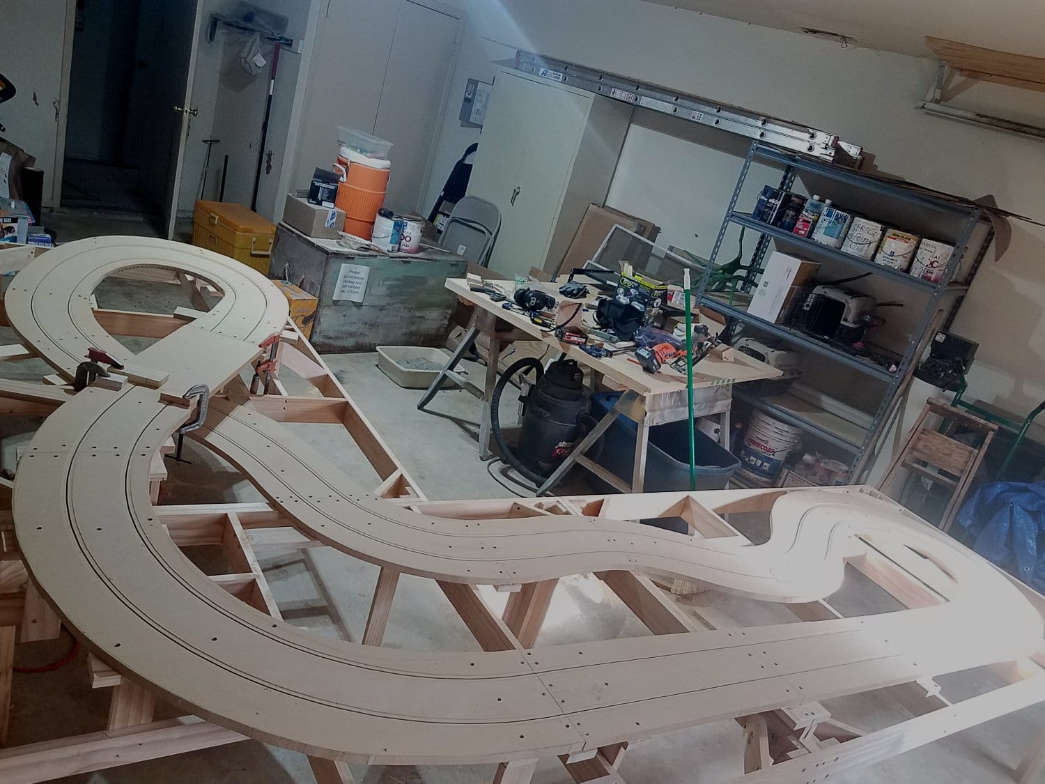

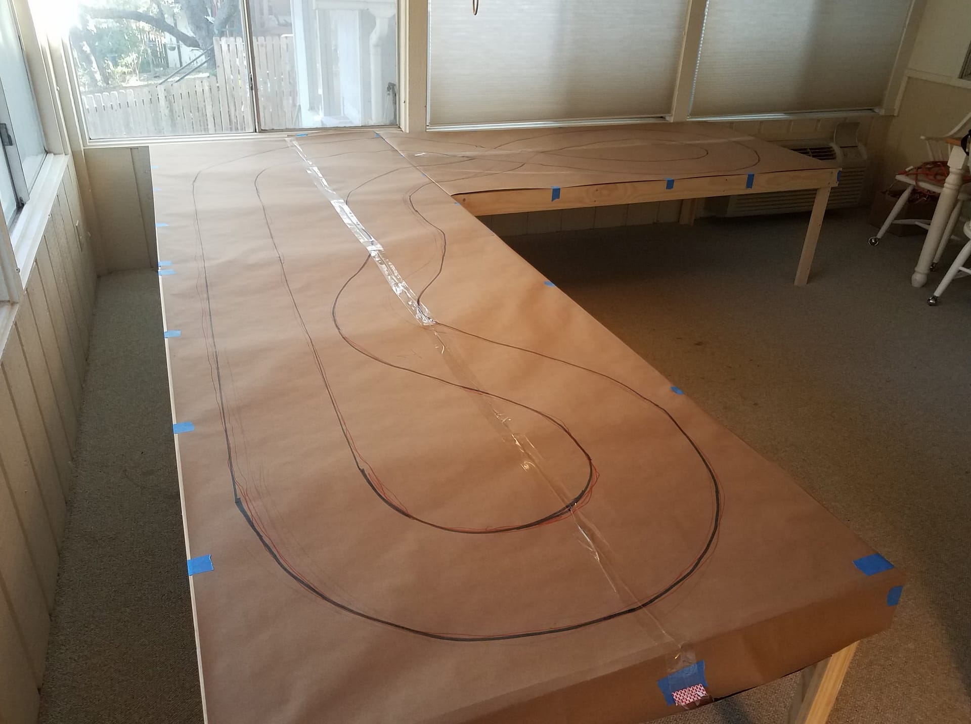

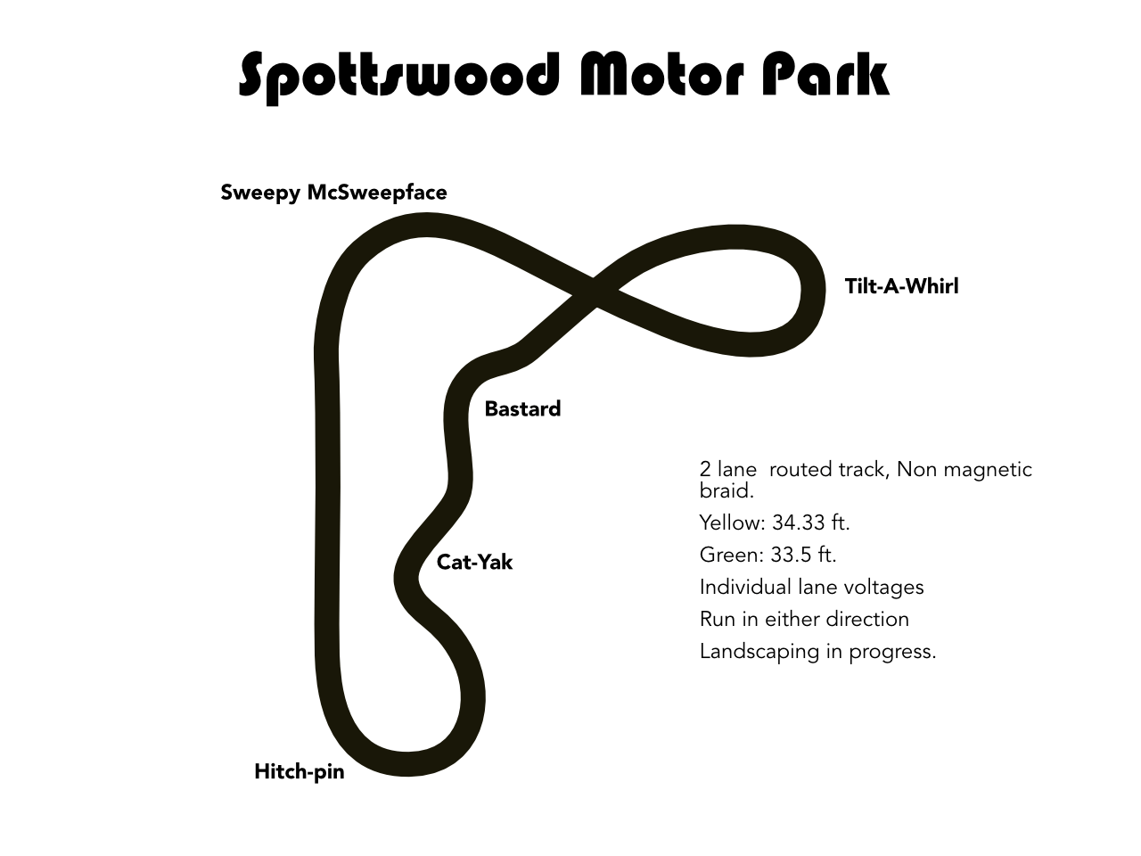

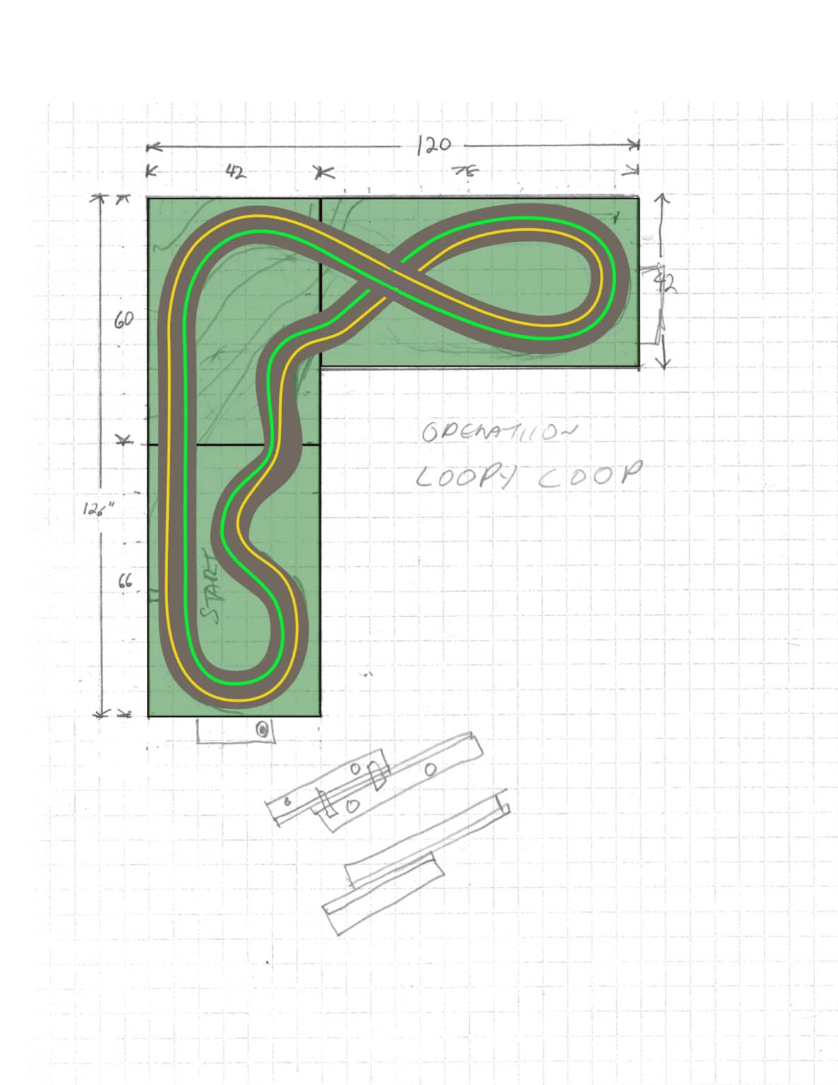

      Well, I have been jonesing for some track time since the lockdown. I had been kicking around the idea of a 2 lane routed track that would breside at Hiedi’s Dad’s house in SA. There is a large, open air-conditioned sun-room. Still playing around with actual track layouts a bit, but the footprint is pretty much set. I will probably build all three tables, and do some prototyping with cardboard for finalizing the route. Below should be a photo of table#1, and a scribble of the layout. I will be bringing it into a vector program to refine the idea. Routing will not be CNC.

            Marty! You are a prince! It that a routing fence in the bottom pic?
            Beginning to play with the shape of the lanes. I keep going back and forth on whether to have a bit of a squeeze at the chicane.

            #15284
            Avatar photoporsche917
              Yes, that is a routing fence.  I have two so you can put them together to make one long run.  Let me know if you want to borrow them.
              I would avoid any squeeze but that’s just my opinion.

              Avatar photoDatto
              Participant
                Marty, I am definitely leaning away from a squeeze. I think it will only add frustration. The temptation keeps creeping in, though.

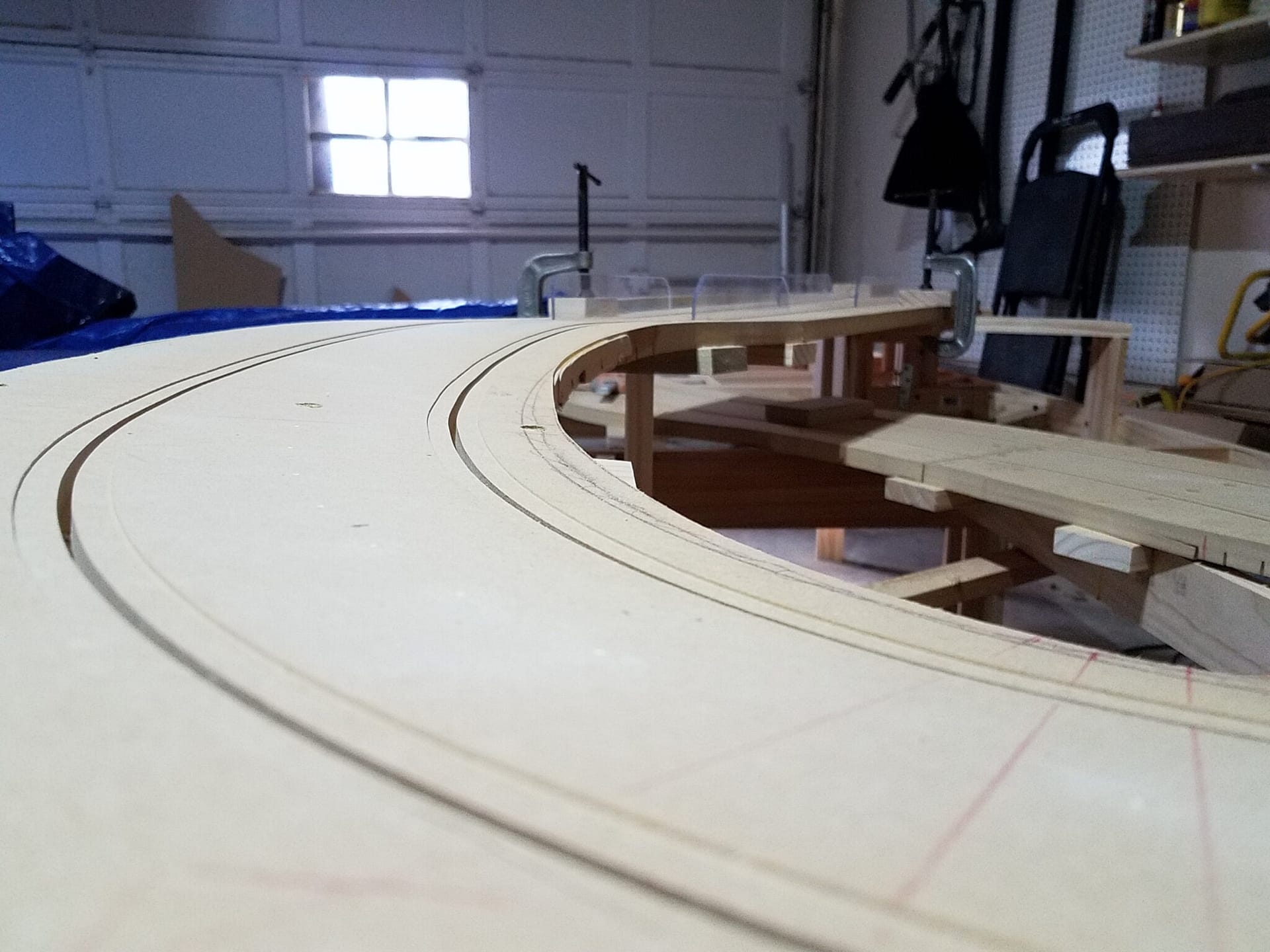

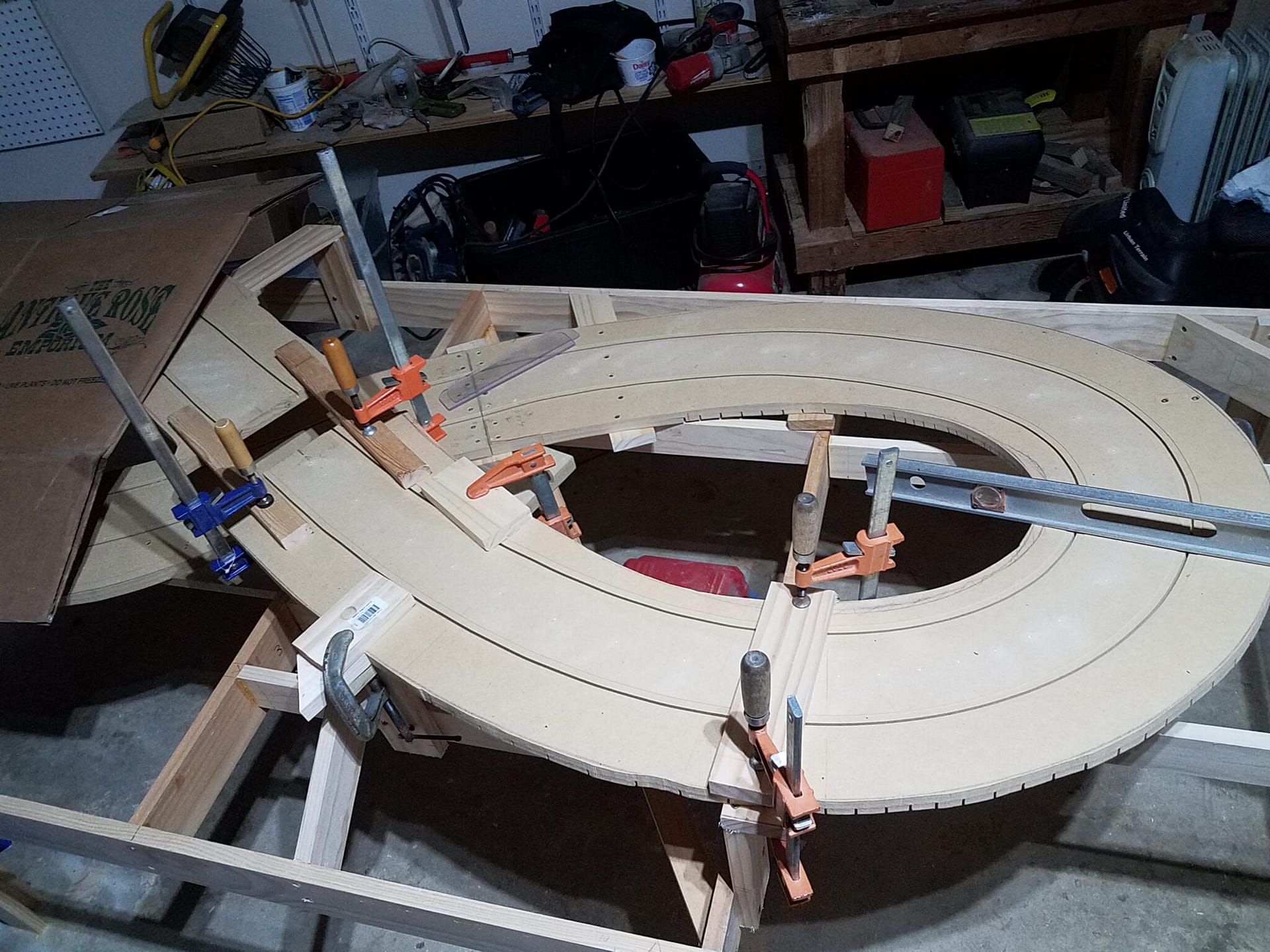

                                  Track surface is drawn out 1:1 and taped to benchwork. Next, mocking up elevations, and checking sight lines.
                                  [attachment file=”15625″]
