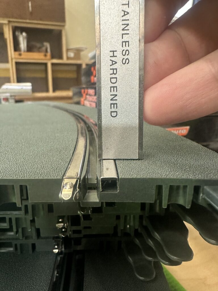

The Track – Plastic track with rails that sit 0.44mm above the track surface, highly magnetic, with a guide slot depth of 8.0mm. I have never raced on a plastic track. This alone is a huge unknown.

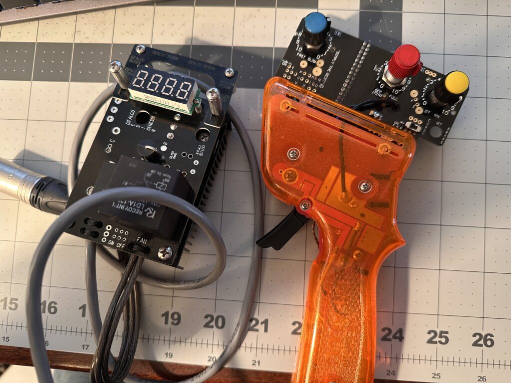

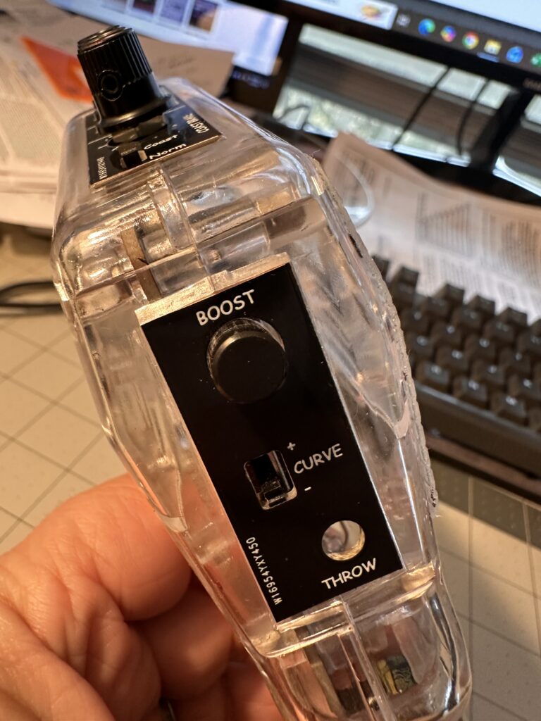

My Difalco DD304 controller. Well, that is about it.
I have my Truspeed Apex at the ready but need more hours with it before I feel comfortable enough to use it for an event like this. Having said that, the tracks we will be running are significantly bigger/longer than anything we have run on to date. With the long straights on these tracks having the option to bypass the choke could be key. The Apex is the only controller I have with this feature.
