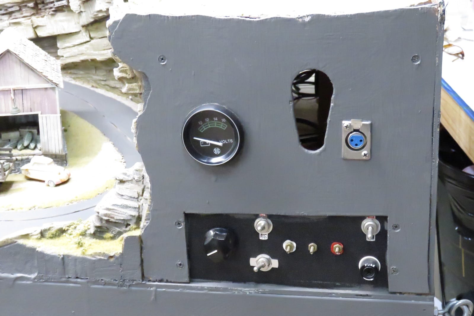

April 8, 2020 at 4:09 PM #14946I have no objection. I use a diode rotary switch for my little 1/43 hillclimb, but that may not be precise enough for the club.
[attachment file=”Driver Station.jpg”]
