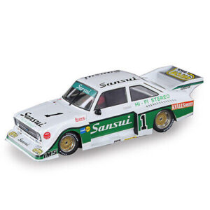

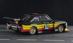

Is the list of cars a suggestion, or the limit? There are other models available in the Group 5 class from Sideways (like the Escort and Stratos).
The Lancia Stratos is on the list if that’s the one you’re referring to, not sure on Escort maybe someone who knows this race better can respond
Erik - I am unaware of any Escort group 5 car that Sideways produced.  They have the Capri and the Mustang but that is all I am aware of.  Let me know if there is an Escort I am unaware of.
Erik,
Holy cow!  Racer Sideways does product a Group 5 Escort.  I had no idea.  Very interesting liveries.
Sideways came out with i think 4 escort group 5 cars like this.
