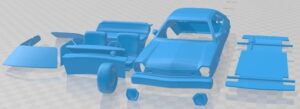

This is all very academic at this point, but I would like to look into the possibility of re-bodying the chassis PROVIDED the new (printed) body A: contains all the detail elements of the Revo (driver, roll-cage, glazing, etc) B: The donor chassis is not cut or altered in any way. C: The replacement body weighs no less than the body it is replacing.
At this point I don't know if it is feasible, but it would be cool to see some Pintos and Gremlins out on the track :)
in reply to Datto
Per 1969 SCCA rules, the B Sedan class has a engine capacity limit of 2000 cc.  So the Pinto raced and the Gremlin was too big displacement, just like my Corvair.  I attended the SCCA B Sedan races that included the A Sedan cars also.  NO Gremlins until the later BFG series in IMSA.  I have thought about using a RevoSlot chassis for a non-RS body.  The C Production Porsche 911's got added to Sedans by 1969 to satisfy Porsche since Alfa Romeo had jumped from the Production classes.  I'm surprised RevoSlot has not added Porsche 911.  John has a Porsche 911 that was the SCCA champion.
in reply to Radial TA
So maybe a pinto? Grind off the big bumpers?
