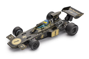

And I have the Ronnie Peterson JPS Lotus.
Lotus 72 Germany 1970 Jochen Rindt
Series managers - I have this car and though I'm planning on running the Ferrari I thought I would do some work to prepare this car to run.  I have to say this car is a pain in the butt.  All of the intricate parts at the rear of the car are not only too fragile but also rub on the rear axle.   I have had pieces fall off, rear disc brake on one side, one side of the roll bar, and another part that I don't know what it was.  These parts look amazing and make the car look very realistic but the parts are also way too fragile.  I bring this up as I am curious how many of these parts will have to be on the car for it to pass inspection to run.

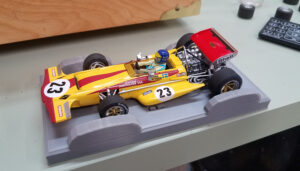

Just a heads up to everyone, there is a width jig for the Policar F! series at HQ by Erik's pit station. If your car drops in without rubbing, it's legal width-wise. Easier than fussing with calipers. If you would like to print your own, let me know if you would like the file. The forum didn't like the .stl.
Very nice!  Thanks for making this.
