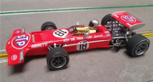

Another Livery in from Policar now available, March 701, Spanish GP, Mario Andretti. Considering this one, in Lieu of the Ferrari.
