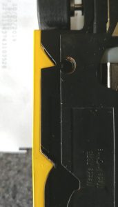

i think mine is the adjustable chassis (new to RTR stuff) There are little inserts with the front axle bushings (plastic) and little removable caps on the axle lower limit spacers.
I watched your video on truing the chassis, but the only semi dependably flat piece of iron I have is the band saw table, and that's maybe a bit big, and attached to the band saw ;)
The adjustable front axle chassis have holes in the top of the axle hoop and the bottom of the chassis that will accept grub screws.  The lower holes are somewhat inboard of the axle hoops.
The adjustment screws are the same diameter as wheel grub screws.  Wheel grub screws can be used for the top screw but longer ones are required for the bottom.  The best screws to use are the ones from Slot Car Corner; they have an oval head.  The available Slot.it screws will work fine, though.  With these screws, the axle height can be precisely adjusted to get the front tires just barely off the track surface.
This setup is one of the minor tweaks that will produce smoother running and slightly faster lap times but will still not result in as much difference as familiarity with the track and getting in more practice laps.
Good Luck!
Russell - thanks so much for posting the pics and making this so much easier to understand.
All - if you don't have one of these chassis in your car you should get one.  It makes all the difference in the world to get your car set up correctly.
