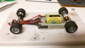

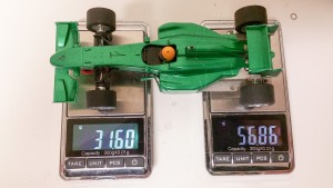

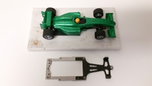

So, in this first picture you will see the car I raced in 2015 and the new chassis bellow it. I just wanted to get some measurements before proceeding.
1

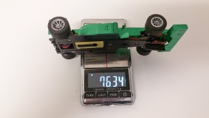

Car weight at 76.34 grams with a distribution of approximately 57% rear and 43% front. I did have a small ballast installed in the front as you will see a fell pictures bellow.

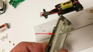

2

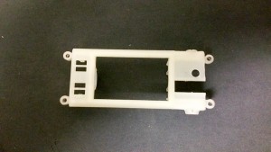

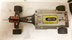

3
Here you can see the ballast (which weighted exactly 5 grams) and a few measurements; again, just something to compare to when I'm done with the transplant.

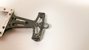

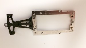

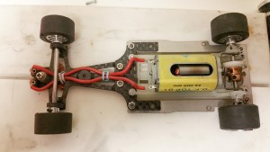

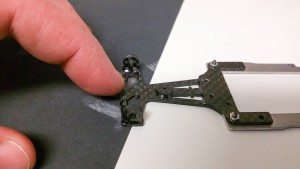

The new chassis came from the manufacturer as you see in the picture bellow. There was some glue residue but nothing that couldn't be fixed.
4

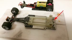

Most of the excess glue would only be a "cosmetic issue" but some of the screw holes were filled and the bottom of the guide holder had a small blob that needed to be cleaned out.
5

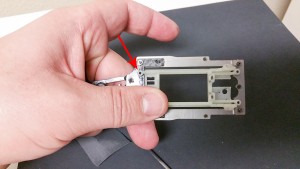

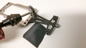

The guide holder is basically a plastic bushing that is glued to the carbon fiber frontal chassis, and there is not a lot of material protruding from the chassis.  With a 500 grit sandpaper I removed the bump.
6

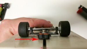

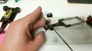

Proceeding with the transfer, I got the guide installed and continued to transfer the front axle. The front axle holder slot needed some filing, the axle wouldn't go all the way up.9
10
Very light filing was needed and the axle was free; with that I installed the front tires and noticed that they were too tall, there was a gap between my setup block and the guide.
Already at the highest axle adjustment, the only option is to reduce the diameter of the front tires. 11

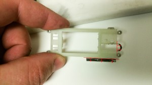

I leave the front tire issue for now and move to the motor mount. The motor-pod normally used with this chassis is from Scaleauto and it costs ~$50 - which I will pass. I grab a spare long can Slot.it motor-pod ($10) and verify that it would fit with a fell modifications.
For the pod to fit all I need to do is remove the crown gear protection arch and the rear side support.
12
13

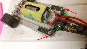

Motor-pod is in, next is the motor. As the gear is now on the opposite side of what I was originally using, I flip the motor upside-down so I don't need to cross my wires.
17

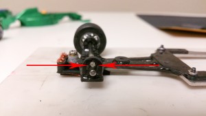

In this image:
Green arrows: The carbon fiber frontal chassis piece is composed of a top and bottom plate which are glued together. There were two existing holes between the two plates where I installed screws for reinforcement.
Red arrows: I checked the body to chassis fit and saw that the corners on the carbon fiber plate ,just outside of the nuts being pointed, were rubbing against the body, I rounded them up with the rotary toll.

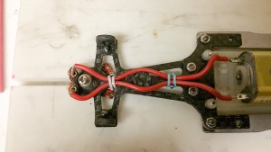

Orange arrows: Those two protrusions are used to hold the leads with the aid of a rubber band.
18
Found some small bands ...

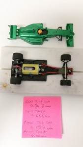

Here is the bottom shot. Measurements are:
Rear tire dia.: 20.3 (unchanged); Rear track: 63.5mm; Front tire dia.: 18.5mm; Front track: 62.1mm.
22

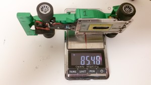

The car, without ballasts, gained some weight: 85.48gr.
23

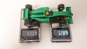

The weight distribution seems to be a bit off, with 64% in the rear and 36% in the front, but the car needs to hit the track before I can come up with any conclusions.24

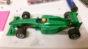

Here is the car finished.25
With the weight increase we may need more "power" to help accelerating and stopping the car, since I don't want to add more costs to the series with the purchase of a new motor, we may race the series at a higher voltage.

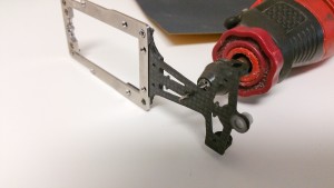

The SVQ chassis has a flimsy nylon sleeve glued inside a thin ring of carbon-fibre. The guide rocks because the sleeve is not thick enough to give a tight fit with the typical shaft of a Slot.It or ScaleAuto guide. With the added mass of the stainless chassis and the power of the long-can motors it's not hard to break this flimsy Guide-Boss.  Preventative or restorative reinforcement can be done with a metal patch.  (1) Alejandro has CNC'ed some aluminum plates appx 2mm thick that can be bonded to the top of the carbon-fibre.  Dremel to fit - keep some 'wings' to reinforce the strut area.
Alexs Alum Plate-2
(2) I have used some 1/24 brass tongues (1.5mm thick) with brass tubing soldered together into a patch I bond with epoxy to the bottom of the chassis (it can also be bonded on top).  The tubing is 5mm (6/32) outside diameter (4mm - 5/32 ID) - by 4mm tall. BTW the guide becomes incredibly smooth in its sweep and has no forward-back rocking.
