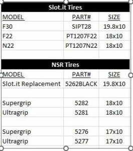

Tires
-Front tires must be Slot.it tires.
-Front tires must be 10mm wide.
-Rear tires can be any 10mm width Slot.it tire or any NSR tire from the list below.
Note as of 2-17-24 - The Slot.it G25 in the 11.3mm width was shown as an approved tire but that is not correct and it is no longer allowed to be used.  This is in keeping with the maximum 10mm width rear tire rule.
-Tires may be glued to the wheels, trued, and have their edges rounded.
-Traction compounds are prohibited.
-Varnishing the front tires to make them slick is not allowed.
-Zero-Grip (front) tires are highly recommended.

Note as of 2-17-24 – The Slot.it G25 in the 11.3mm width was shown as an approved tire but that is not correct and it is no longer allowed to be used.  This is in keeping with the 10mm width maximum rear tire rule.
