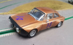

I'm running the blue Alfa.  This would be very difficult to modify the car number so hope no others run this.

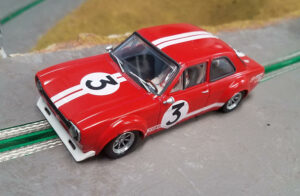

I believe I will be running this Ford Escort.
