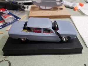

Here is one of the cars I plan to run, a 1961 Corvair
I have a running car, or I had, anyway. The 3D printing resin I have ben using takes beautiful detail, but is brittle. I reinforced the horizontal surfaces (Front trunk lid, roof and rear deck but a fall to the floor found the weakness.

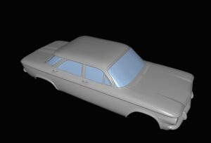

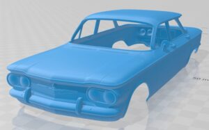

I started out trying to make vac-form tool for glazing with clay, but decided to do it in the 'puter
[attachment file="17502"]
[attachment file="17503"]
[attachment file="17504"]
I believe the 1961 Corvair fits under Ralph Nader's statement of "Unsafe at any Speed".  :-)
That Corvair looks like my 1967  Monza after I t-boned a 1964 Buick Electra four door at about 15 MPH on my part and 30 on his part.  It showed up 6 months later repaired!! on a chevy used car lot.

MARC - great build, but looking forward to your 2nd edition with maybe a less brittle resin compound.

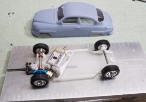

It's a Saab, so I figured go weird, or go home. Printed 16 body is reinforced with fiberglass, and pictures is first prototype of a FWD angle winder chassis. I wonder how, or if it will go!
[attachment file="17517"]

Marc - reminds me of a SAAB one of my more "crunchy" high-school teachers owned.
Looks cool as a slot car - good luck!
