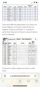

Regarding the magnetic downforce issue we discovered yesterday -
While almost all of us went over, it seems like there is still a fairly wide variance with going over.  Correct me if I'm wrong, but I remember the highest being in the high 40s or maybe even low 50s?  Mine was at 31 and John's was the only one within the standard limit of 30.  20 more grams of magnetic downforce seems to be quite an advantage to me, even if I am relatively new to this.  I don't really see it as being reasonable to ask everyone with magnetically hot motors to buy replacements until they find one that's within the limit.  Equally, I don't see it being reasonable for people that end up with motors with lower magnetic downforce to buy several until they get one comparable to the higher numbers.  That seems counter to the spirit of a spec series.  Is it sacrilegious for me to suggest we up the limit to reflect the maximum we saw with a stock motor and allow those with lower numbers to run magnets to match that downforce?  There's lots of teeny tiny magnets available to fine tune it.  I learned the art of this in Houston.

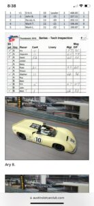

By far the biggest factor affecting downforce is tire diameter.  Downforce is inversely proportional to the square of the distance  between the motor and  the braid on the track.   If you halve the spacing the downforce would be 4 times as strong.⁸ To decrease downforce, true tires to a larger diameter.  With the Thunderslots I think we are all using as small  a tire diameter as we can get without the chassis or spur gear dragging.  Motor pods in a series with adjustable offset ùmotor pods, the downforce would be adjustable.  I think trying to adjust downforce with magnets would be a futile exercise.  Buying extra motors, mounting them in a chassis to find acceptable downforce would be expensive and probably also futile.  We ran the series 4 previous times with no limit on downforce and my preference would be to "forgit about it".

its of a pic in 2019 checking downforce
