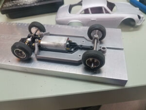

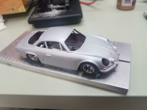

Progress on the Alpine. Body is looking better but still rough. Chassis was easy, hope it runs well.
Chassis is a runner

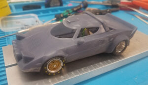

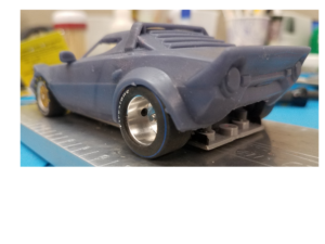

Group W entry, a Lancia Stratos. It looks like I may have stumbled on a mix of resins that combines decent surface quality and (we hope) sufficient durability. Slot.it running gear, still on the hunt for wheels and tires.
As a Lancia Stratos team member I am allowed to share with you the source for wheel inserts.
Believe I’ll give this a go.

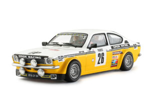

Opel Kadett Monte Carlo 1979
Tanner,
Unfortunately only plastic chassis cars are eligible. Rules will be up soon.
Tanner - I don't think that car will be allowed as it has a metal chassis.  Usually, only plastic chassis are allowed unless the series is for BRM or RevoSlot where those cars all run a metal chassis.  I am not the series director but I am sure he will have rules posted shortly that will help everyone make a car selection.

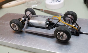

Car and Number:  Fiat 131 #1
Class: Over 8mm
RTR Manufacturer:   SCX Body
Stock? Yes-ish
Somewhat kitbash. The chassis is 3d printed, sourced from somewhere on the Internet since I bought the body-only on eBay. The motor is still up in the air since I haven't finished testing options at this time, but it is a long-can, inline setup using Slot.it wheels, axles and bushings at the rear. The front is almost certainly Slot.it wheels and axles, too - but I simply grabbed them from my boxes, checked to see if they fit, and they did. So no telling where they were really sourced from. At the moment, there are Slot.it F30's on the rear. I'm terrible at recording where I find stuff, but the guide is supplied by an un-remembered slot car manufacturer and it allows for many different lengths. Currently, I've got it pretty small, but haven't actually measured it - if I had to guess (since I don't have the car with me right now) it is between 4-5 cm. Since my tests on this recent Test N' Tune evening were very promising, I should likely start creating some solid notes about the thing. I am using some Pendle guide wire. Currently, the car is set up to run the body's built-in LED lighting setup. We'll see if I retain that. Since I bought the body by itself, I had to supply body screws - I'm using some aluminum 5mm? screws from Pendle with which I have become enamored since they use a hex driver.

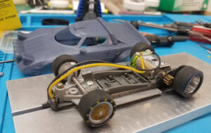

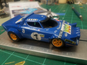

Driver: Datto
Car and Number: Lsncia Stratos HF 1980 #1 Darniche-Mahe´
Class: Over 8mm
Scratchbuild
Body shell: 3d print from purchased file..
Paint: Acrylic, Decals Rallye-Miniature Fr.
Chassis: Home design print and Slot.it Sidewinder pod
Motor: Predator 18k
Wheels Slot-it/ CB Design, Tires Paul Gage Urethane.
Interior Vac-form, figures Immense Miniatures.

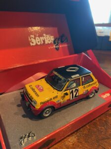

Driver tl1950,
Car: Le Manns Miniature Renault 5 Alpine Gr2  ,  #12
<8mm
Stock:  only mods, rear tires, 30 Shore A, Le Manns  Series GTS #SPA132035
