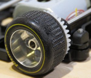

Also, the stock tires (rears) on the model I received have really nasty, distorted injection sites. I doubt the tires can be trued. Is this normal?

Great questions. You can run those tires but they will need to be trued all the way down to where they have no tread. The easier and perfered method is to use the Thunderslot slick rear tires. Having said that, they are unavailable from any on-line slot car retailer in the States. I just ordered the last three bags (12 tires) from Armchair racer in Australia. I ordered three bags with the thought to sell some, at my cost, to other racers that can't find them.
The slick tires will need to be glued and then trued to make sure they are 100% round. It makes a big difference in this series.

First of all, about the tire with the injection dimple, once trued, the original, treaded tires will work fine; I believe they are the same compound as the slicks. Perhaps truing all the tread off will yield slightly more "rubber on the road", but sanding them round will probably be sufficient. Neither will it be necessary to remove all traces of the dimple/injection. As long as the area around the imperfection is level it should be OK. You want to be careful and not over-true the tires; there is not much clearance under the chassis and you don't want the chassis to drag.
On hubless wheels, where the set screw hole for the wheel is inside the width of the tire, requiring the edge of the tire to be curled back to get to the grub screw, I use a leather punch to make a hole in the tread of the tire. This does not affect traction.
