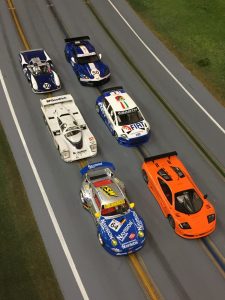

Happy New Year 2018 Series!
Nice picture Randy!  Those are some good looking cars.  You should take the same pic at the end of the year and see what the comparison looks like.
