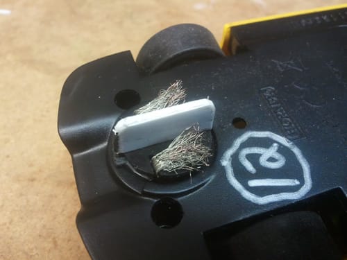

The Lightning GT race last Saturday was much improved from the first race, but there were still some issues.  Some of the cars had random de-slots, particularly in the turns where the slot has worn down.  The stock Scaley guide flags are thin and don’t have much depth.  I modified one by adding plastic to the sides of the flag and extending the depth.  The stock braid discs still fit.  This worked well.  I will modify all the guides.  I have three guides myself and can swap out with members for the unmodified guides.
