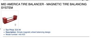

I was looking at this one, but I'm interested to see what Alex prints.
[attachment file="17696"]
The Mid-America balancer is all aluminum and not adjustable, but fits:
  • 50mm and shorter axles
  • Long-can uncut, Armatures
BTW - a pointed axle looks cool and I am sure with $1mm lab equipment probably can be measured as "focusing" the magnetic field, BUT is NOT critical to actually do the balancing process.  It basically allows the end touching the plastic cover (over one magnet) to have minimal friction and minimize any effect of a Not perfectly Flat axle end (e.g. from a bad cut when they cut off the drill blank).
Bottom Line - If your tool does not come with a pointed axle, with a few minutes (and patience) with a Dremel you can round or point one of your spares.
Mark,
The Mid-America balancer shown in Brian's post is adjustable.  The magnets on each end move in or out as needed to get the proper adjustment for the axle to move freely.  Once in the correct place, they are held in place with set screws.  The pointed end is highly critical for the tool to work properly.  Having the point in the absolute center of the axle is the trick for the tool to work correctly.  If the points are off the tool will not work.
I own two of these tools - one from TWP/Mid-America and the other from Kolhoza.  The Kolhoza is the better of the two.  I have not used it to set up wheels or gears yet.  I will be using it for the CanAm series later this year where wheel RPM will be 7K-9K.  I will be writing a report to detail how it works and if it's worth the time and money.
