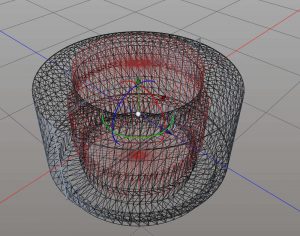

First step was to measure the Thunderslot wheel and tire, and then make some 3D files for printing.
[attachment file="Wireframe tire.jpg"]

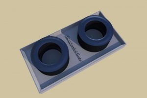

This was exported as a .stl file, and set up for printing on my resin DLP printer I gave the tire a little standoff and placed it on a base, so that with any luck the back side of the tire won't be to hard to tidy up.
[attachment file="Mold Tray Render.jpg"]

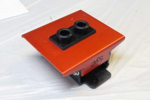

Here is the printed part on the build-table
[attachment file="02-part on build table.jpg"]

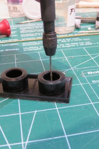

Now to make a silicone mold. I drilled some vent holes in the base in hopes it will ease de-molding. Remember to tape them up, though, or the silicone will run out.
[attachment file="03-vent hole.jpg"]

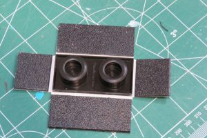

ABS sheet is used for mold walls. Taped together flat like this, so the walls can be folded up and taped for a re-useable mold box.
[attachment file="04-mold box.jpg"]

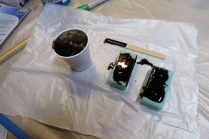

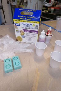

Urethane is next. This is a 30 shore Urethane from Smooth-On
[attachment file="08-urethane.jpg"]
Black colorant is added, parts a and b are mixed, de-aired in a vacuum chamber and poured (very slowly) into the molds
