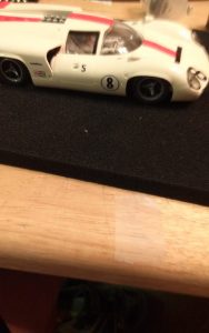

I had a great time doing my first race today, even with a wonky car. Tight body screws, tyres need a little more truing. All thd club members are great, welcoming and very very helpful. Its a learning experience and I am looking forward to the next race and growing.
