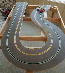

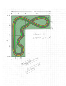

Well, I have been jonesing for some track time since the lockdown. I had been kicking around the idea of a 2 lane routed track that would breside at Hiedi's Dad's house in SA. There is a large, open air-conditioned sun-room. Still playing around with actual track layouts a bit, but the footprint is pretty much set. I will probably build all three tables, and do some prototyping with cardboard for finalizing the route. Below should be a photo of table#1, and a scribble of the layout. I will be bringing it into a vector program to refine the idea. Routing will not be CNC.

Beginning to play with the shape of the lanes. I keep going back and forth on whether to have a bit of a squeeze at the chicane.
Yes, that is a routing fence.  I have two so you can put them together to make one long run.  Let me know if you want to borrow them.
I would avoid any squeeze but that's just my opinion.
Marty, I am definitely leaning away from a squeeze. I think it will only add frustration. The temptation keeps creeping in, though.

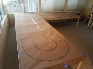

Track surface is drawn out 1:1 and taped to benchwork. Next, mocking up elevations, and checking sight lines.

Things are looking good.  I am enjoying watching the track progress.  Thanks for sharing.
Some progress on the track Track surface routed and cut out (four pieces) There is some rabbeting I want to do on the edge of the trackway, so I can have a recessed notch to attach landscaping materials (latticework and paper mâché). I used some cut ends of braid to test routing depth of the gains to come close to the track at HQ. I think I am in the neighborhood. Also trie paining the lane/slot color with an airbrush. That seemed to go okay, so I did a full-up paint test with some flat latex I had bought last year.

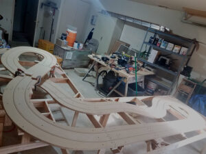

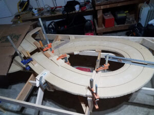

Major carpentry, I think is done barring any delayed stress fractures, or things like that. The three tables have been separated, at least the track itself has been cut, using a Japanese dovetail saw, to ensure the thinnest kerf. The track is a complete circuit the final bridging piece having been cut and routed. Tinned copper braid is in from Slot Car Corner. The Magnetic braid in the size reel I need has disappeared from their website. But I don't run magnets, it was intended for my father in law, but variable track voltage will have to do. Track construction went mostly as planned, but I did end up with a little hump, jut before the overpass bridge. Do I dare to try and sand it down, and re-rout, or chalk it up to "Technical"? Ideally think trying to use a router on a compound curve is asking for trouble. Here (I hope) are some photos.
[attachment file="16197"]
[attachment file="16198"]
I was imagining driving through it, and it seems very fluid. I can't wait to see a video recording of a run. As aways, incredible workmanship.
What a great looking track.  Thanks for the update.  It is coming along nicely.
On the "hump".  It depends if it will cause the cars to de-slot as they go over it.  The typical rule of thumb is:  The track can not cause a de-slot due to a construction issue.  If you can drive over it with just a bump and no de-sloting I think you are ok.  If not, you may want to think about sanding it down.  I had to do that on my home track.  I did the re-routing with a hand held router that was easier to control.  I would wait to hear from Russell to see what he thinks.

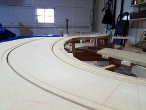

Bit of a hump before the bridge.
Bit of a hump

It would be preferable to find out before paint, braid, etc. if I have a problem. Not sure this will work, but I threw together a self-powered test car. Super mild motor, short gearing, and 9v. I will try it on the bare wood, and see what I can learn.
Mule

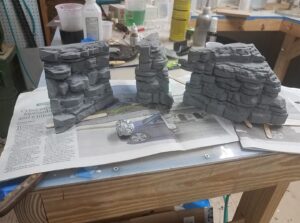

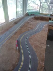

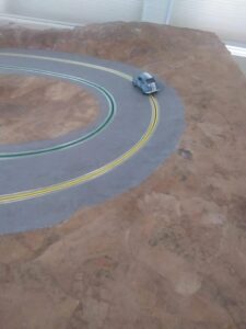

Track is operational, timing system installed. The Paper MAche' shell is almost complete. Need to work in the foam rock work, and I want to get that part mostly painted before sticking down.
[attachment file="16776"]
[attachment file="16777"]
[attachment file="16778"]
That looks great.  How does it drive?
Great looking rocks Marc :)
[postquote quote=16781]
Well, I'm having fun with it anyway. No terrible kinks, that I have found, but there is a "bump" on the green lane at the table join. Can probably shave it down. Very different character when you switch directions.

Thanks Mark. Lots of reference around here, living at the bottom of the Niobrara sea. ;)
