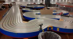

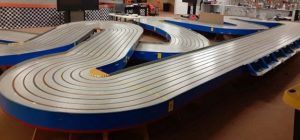

Attached are some images of the 8-lane, over 100ft track.
One is of the drivers stations and 10 ft long front straight.
The other is of turn-1 and shows the other turns and climb/doughnut leading to the straight.

That is an amazing-looking flat track.  Is it actually up and running?  Does Tom offer any open practice sessions?  It would be nice to try out the track first and see how it is and then have a conversation with Tom about doing something.
Personally, I have zero interest in wing cars but I would love to get a Scaleauto or BRM on that track.  There is something really fun about getting the 1/24 scale hardbody cars on a big track like that.

A friend confirmed the track is fully functional complete with Timing system.
Not clear if there is any glue - but it would be Light - again - for a 1/32 car all you need to do is swap the rear wheels for a $12 pair of Soft foam wheel/tires and mount with a 4-40/0.05 Allen wheel wrench (same as NSR and Thunderslot).
Open practice - Saturdays and Sundays when the paintball field is open.  If Debra is there and too busy to start the track, ask if "Todd" or "Josh" are working and can turn on the lights and start it the track and computer.  Payment can be made to Debra or later via a paper log on the Pro-shop counter.

--  Driving (clockwise direction) - there is a long straight, but near the end you need to maintain speed to pass over the Lap-Counter 'dead-spot' (then brake immediately before the corner and ease through the small Esse/chicane).  In most corners lots of feathering is required.  In the very last corner/esse, it is Hot after a short straight; after you round the corner after the straight, power jumps a little right before some tight final esses leading into the front straight.
